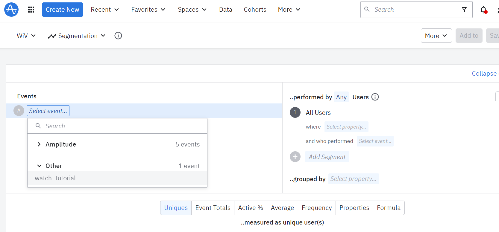

Hello! I already committed and saved my new event (test). However, it’s not coming out when I attempt to make a chart. How might I be able to resolve or work around this? Thank you!

adam.s Gabriel Guilhem mate apologies for this, it looks like there was a delay in data processing. I think some of you have cleared this by logging out and logging back in. Please let me know if the issue persists. And I’ll update this thread once we hear from the eng team on what caused this issue.

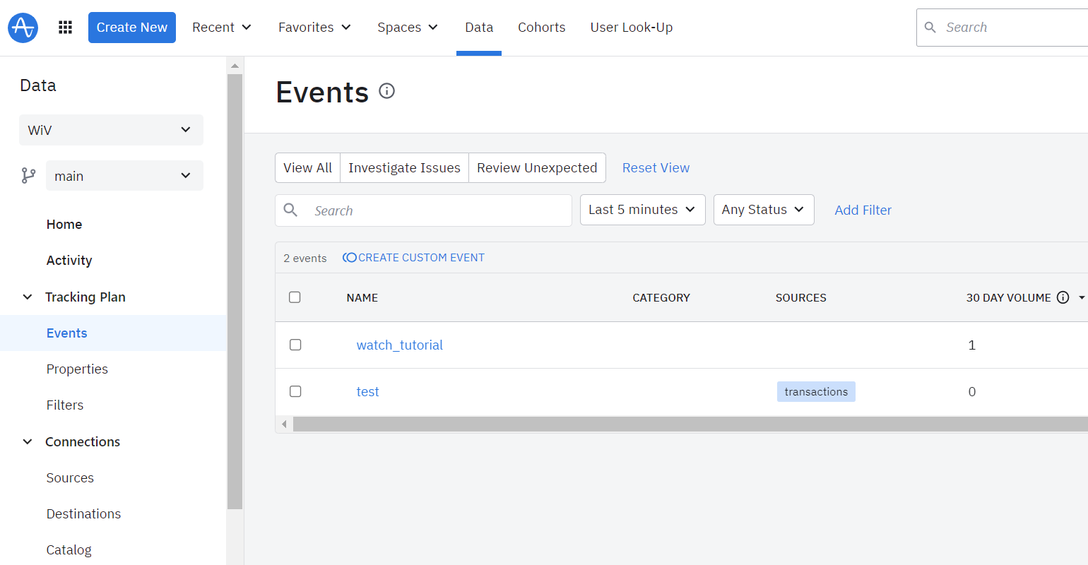

We also have the issue mentioned above. New event that shows in “Data”, it was “Unexpected” so we set it to “Live” and has data coming in. But we can’t select the event when building a chart.

Luke Hopkins sorry about the long delay here, just wanted to check in and see if the data did start appearing properly. There is a delay in data processing but this can be cleared also by logging in and logging out, or clearing your cache.
I have the same issue: I have all events coming from website, on both environments (dev and prod), and I also checked the api tokens and see all correct numbers in “Data” section.
But i’ve spent about two hours already to make it work, but still no luck.
I can’t select the events when i’m trying to create a chart, they are just not in the list. However two of the events appears there from those that should be.
I’ve tried to log out/login, and twice cleaned cache and localStorage, but it didn’t help.
