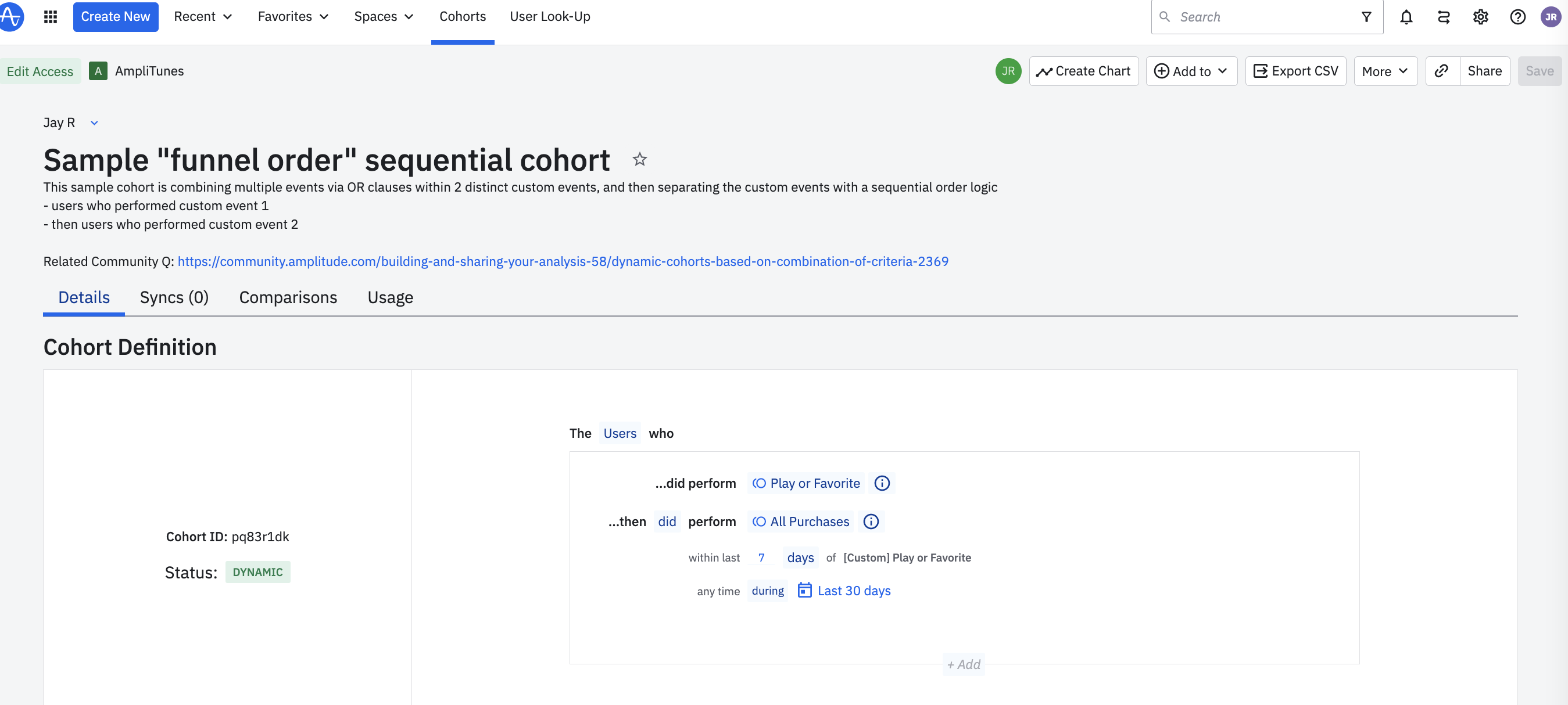

Hey Vaibhav Gangakhedkar , adding to Saish Redkar ‘s recommendations above to highlight then logic that is available in cohorts.
Step 1:
You can build 2 separate custom event on the optional events
Step 2:
Then in a cohort you can apply the following “funnel order” logic
Here is a sample cohort leveraging this then logic with 2 custom events in our Demo AmpliTunes org.
The key difference is the cohort built from the Microscope function will be a static cohort limited to the original chart’s conversion window & time range lookback period.
Meanwhile the “funnel order” logic embedded within the cohort will enable your cohort to continually enter & exit new users with your defined conversion window & time range.
I hope this helps!

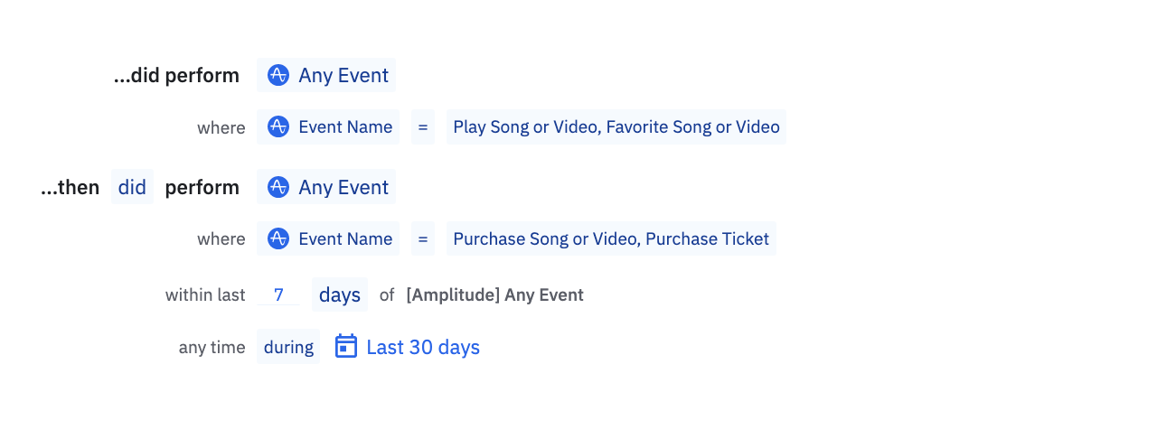

Vaibhav Gangakhedkar completely agree, this is a strong use case and perhaps it doesn’t always make sense to build a custom event if it’s only going to be leveraged in a few inventory.
An alternative suggestion on how this could be built, if you wish to bypass the need for a custom event - you could leverage the Any Event syntax where Event Name = Event A or Event B, similar to the screenshot below. The caveat to this example is that you can’t specify different properties for each event.
Any Event
Event Name
So if you needed to set the granular conditions below, then a custom event would be required at this time to support this use case.

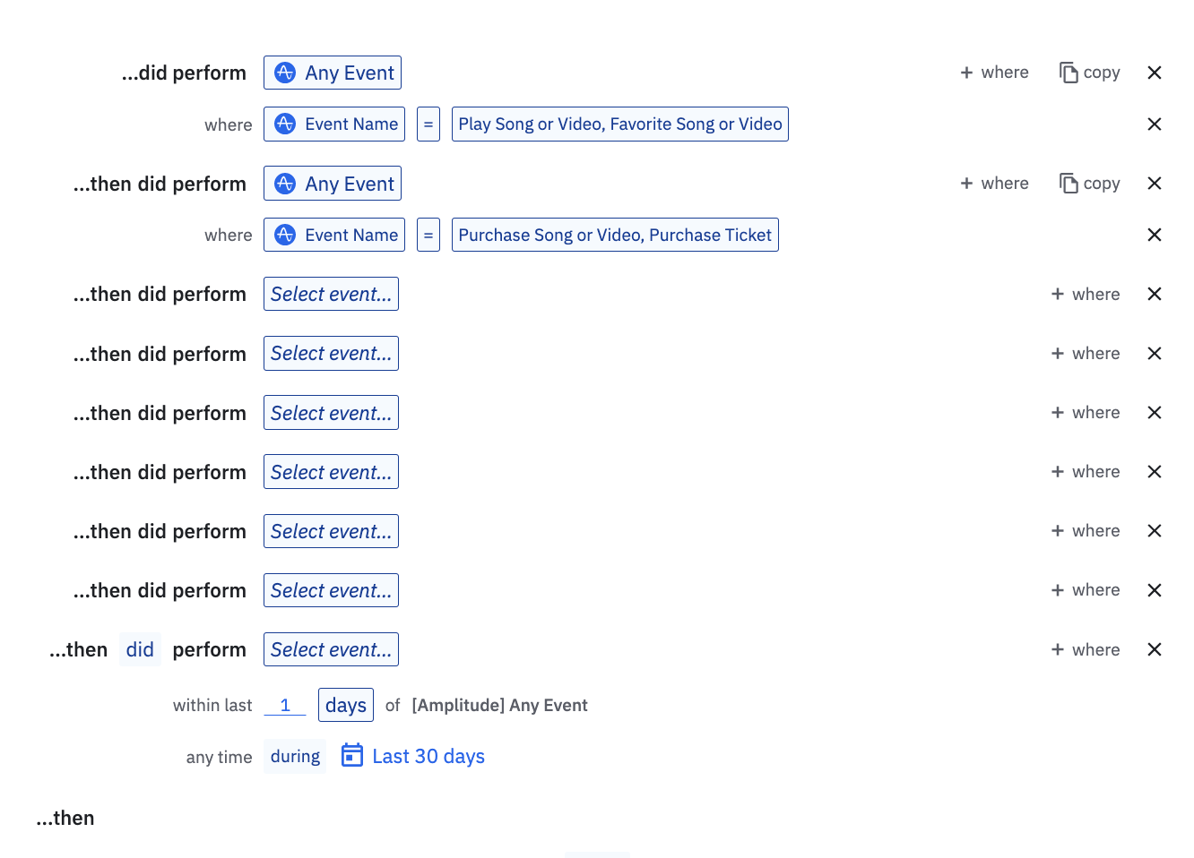

I updated the sample cohort referenced above to factor in this setup as well.
And I don’t believe we have a cap on how many “Then” conditions can be added within a cohort

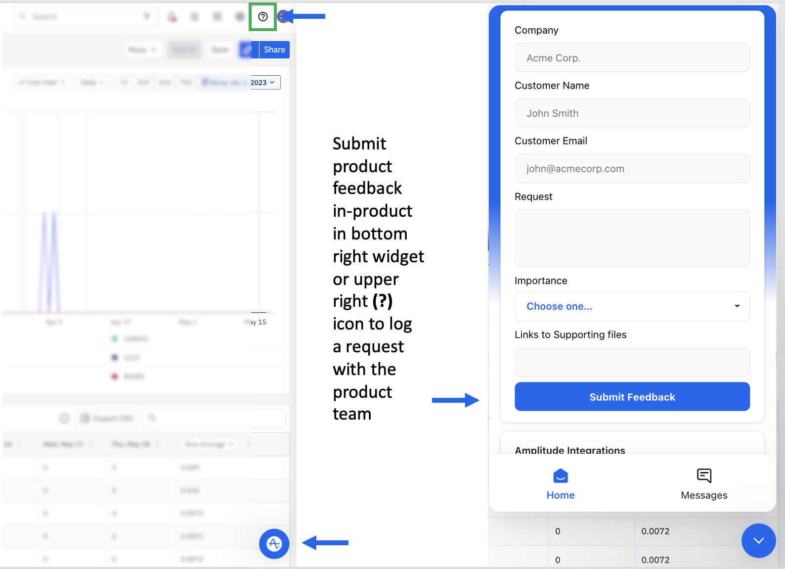

If you have an additional use case that you’d like to setup outside of these proposed parameters, please submit this feedback in-product in the bottom right Amplitude logo widget to our ProductBoard feedback submission form. That will greatly help the product team prioritize the request, thanks!
