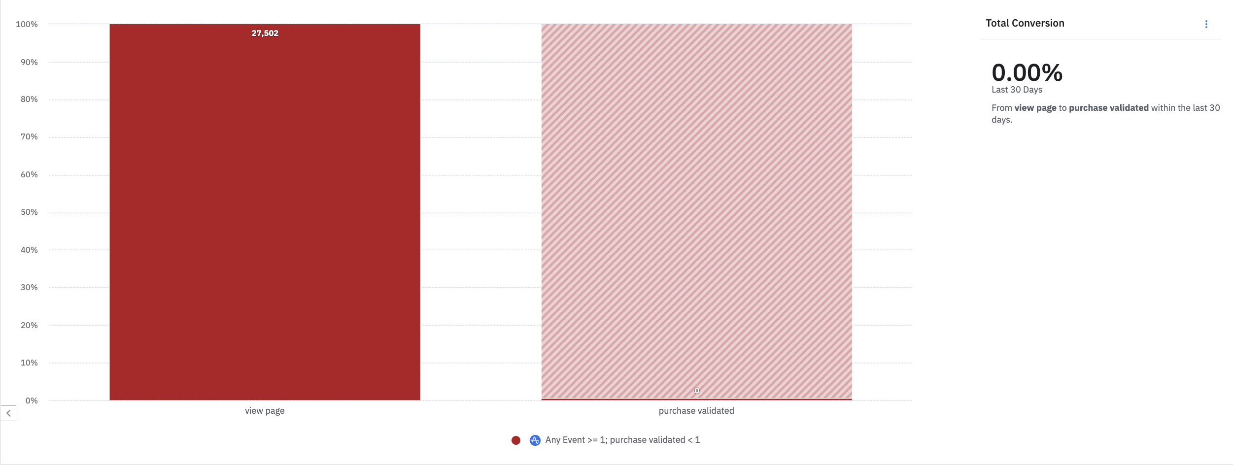

I am trying to build a conversion funnel answering the following question :
What is the conversion rate of visitors that never purchased (since Nov 2021) when entering the funnel ?

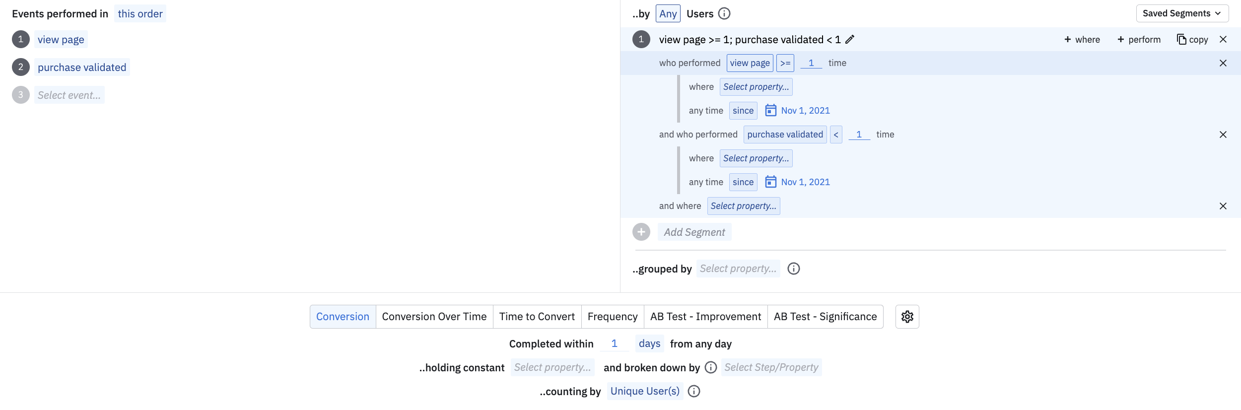

I have tried many configuration including the following one :
Which gives me a 0% conversion rate ?
It seems that the segment condition are applied to all events of the funnel, not only the first one.
Would you know how to solve this issue ? (without using derived properties)
