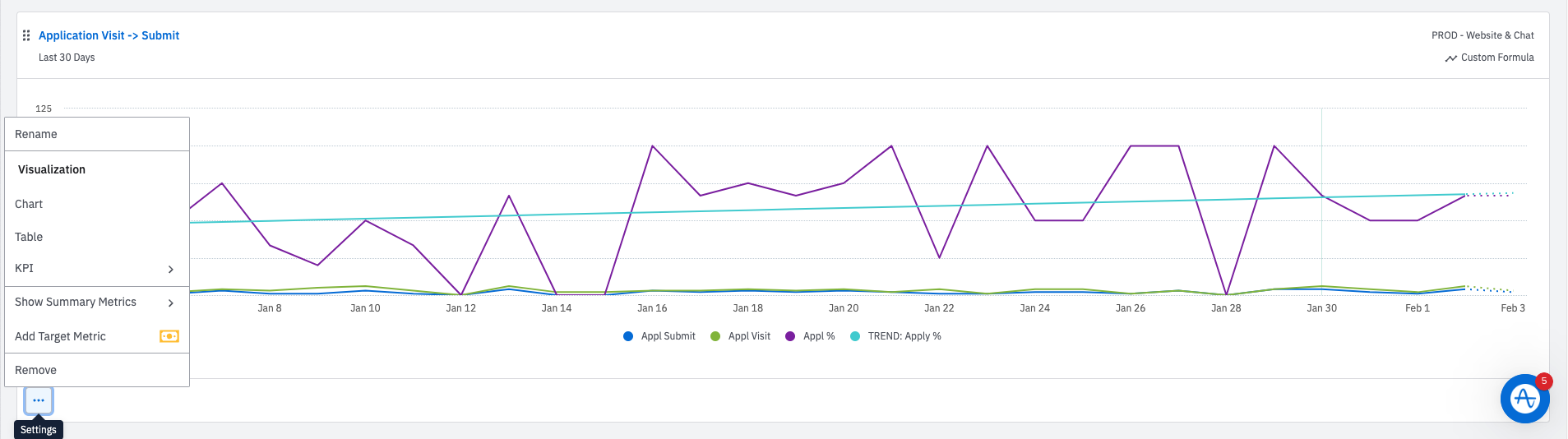

I can’t find the “Decrease Width” button on the dash making it useless. Where do I find it now?
See below screenshot.
Hi richa ! Welcome to the Amplitude Community 👋
We've actually made some changes to the way that we resize and arrange content on your dashboard.
You will now be able to drag and drop an item into an existing row within your dashboard, and the item will auto-fit into that row if it’s not full (there is a max of 4 items per row).
You will also now be able to resize items in a dashboard by hovering over the padding or gap between items and dragging a bar left or right.
