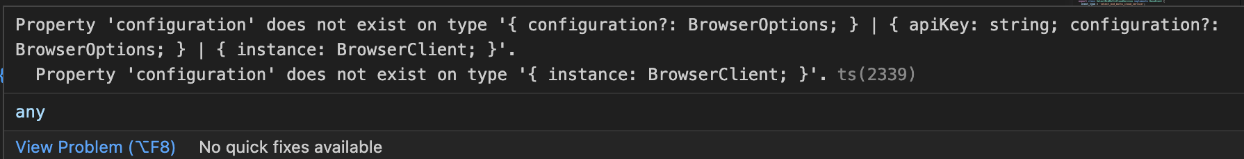

Currently working with the engineering team on this. By chance do you have a screenshot of the error you’re seeing?

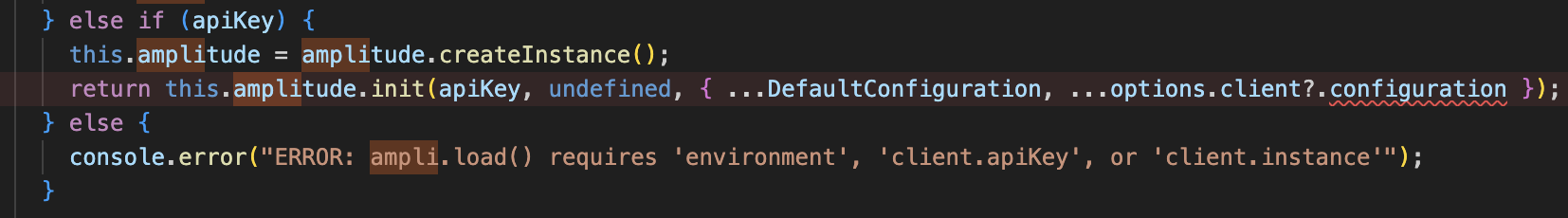

hi,
when generating the ampli wrapper , we get this ts error in the code in the ‘load’ method -> “Property 'configuration' does not exist on type '{ configuration?: BrowserOptions; }”
