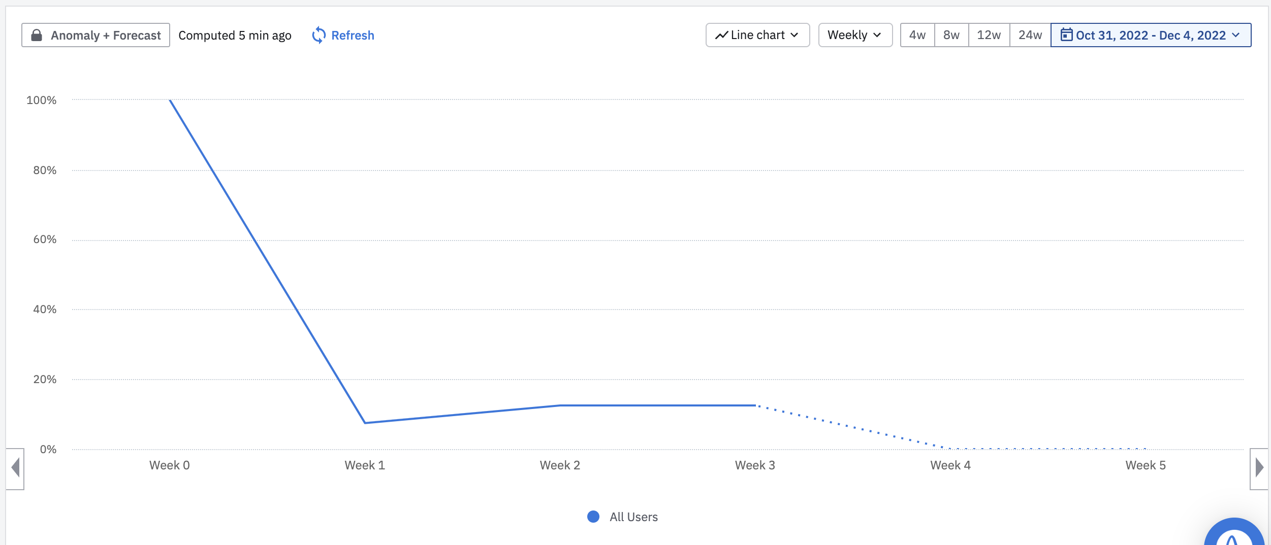

Thanks!I did it here!It still shows me different “of” numbersAny additional ideas why?
Week 1 - 5 of 57
@week 2 - 5 of 40
Nate This seems to be related to the length of your date range which is over a week. For instance, let’s take a 3 weeks long date range that you analyze weeky (thus computed using a 7 day-window):
Here’s an example on Amplitude demo: https://analytics.amplitude.com/demo/chart/new/av8cflw?source=copy+urlI concluded by thinking that the amount of “rolling time window” periods within your date range will equal the amount of consecutive decreases at the end (second to last) of your retention graph (example: with a 5 weeks date range on a 7 day-window, you will have 5 decreases on the 5 weeks prior to the last one). Hence, I would not take a look on the latest weeks given depending on your chosen date range. Once again, I hope I’m right. 😂
