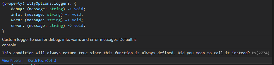

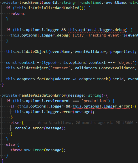

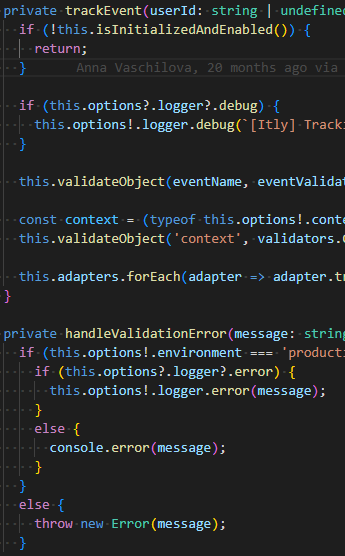

After running ampli pull in our project, we receive the following typscript error on 2 lines. It’s a very easy fix but it’s frustrating to need to change it every time we regenerate.
