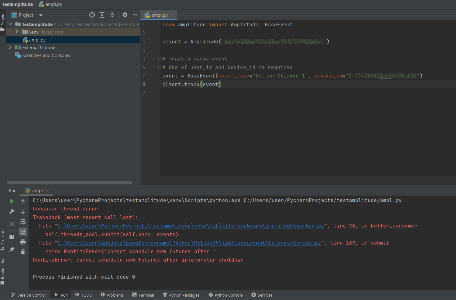

There are no blockers and I’ve reinstalled the Pycharm again. I followed the basic tutorial and now get the following error:
What could it be? Do you have any ideas how to fix it?

Hi Denis Holmes,
You were absolutely right regarding the version issue. I’ve tried 3.10 (the latest on Python website) and 3.9 and got the same issue. Verion 3.7 worked well for me and I managed to send the event data via API.
Thanks for your help!
Regards, Sergei
