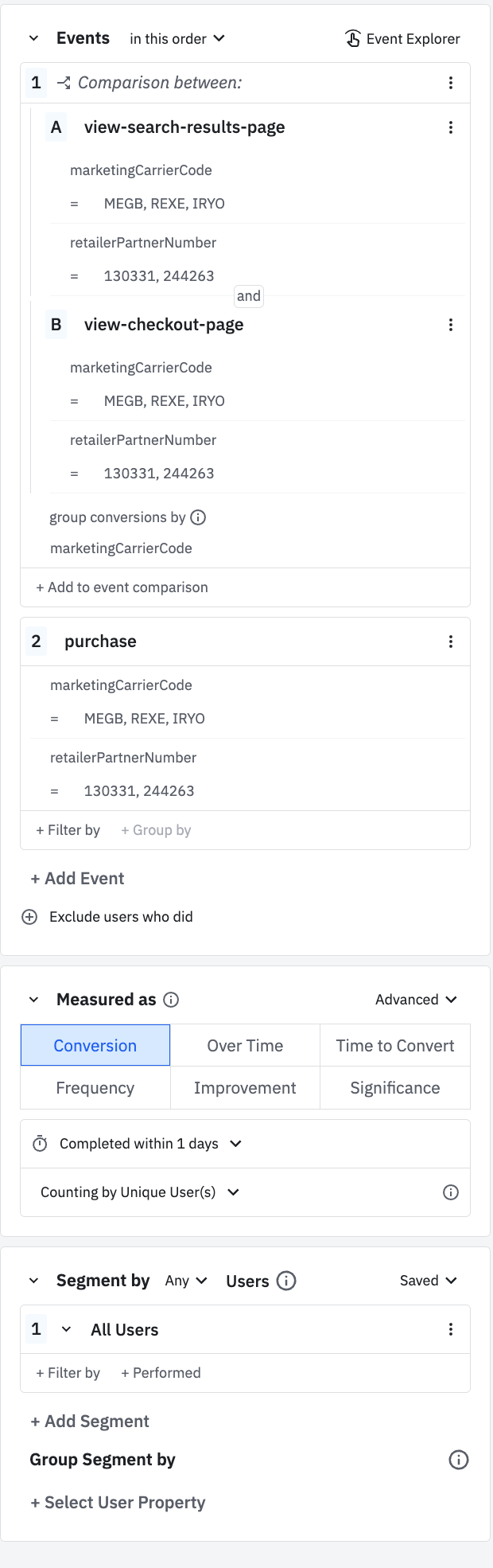

I have set up a chart to compare the conversion difference between users:
- who started with (1A) and then (2) = flow 1A2
VS.
- who started with (1B) and then (2) = flow 1B2
as follows:
- I wonder if this is a correct setup
- The user U1 who started with view-search-results-page had to go to checkout page and triggered view-checkout-page prior to end the journey with purchase.
The user U2 who started with view-checkout-page went back to view-search-results-page then view-checkout-page and purchase.
The question is: can we be sure that U1 is only counted in flow 1A2, and U2 is only counted in flow 1B2?
