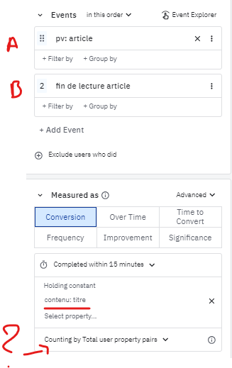

I would like to know how many of my readers read my articles completely in other way how many percent of from all my articles are read from A to Z ?
To do that, i have an event A that tell me that my user are viewing the article and then after some scroll down and some time spend on the page an other event (B) told me that they have finished the article.
So my guessing was to do a funnel chart from event A to event B, however how to to be sure that the event B is from the same article than event A ? It’s also possible that he starts reading one article, did’nt like it, went on anohter one and this time finished it and so trigger event B.
Can we solve this by using “holding a constant” by the url or the name of the article, to be sure he stays on the same article ? And should I count by Unique or by total ?
Can you help me with this by answering me if i’m doing it correctly or not ?
Thanks in advance !
Here is the screen of what I think is right :
