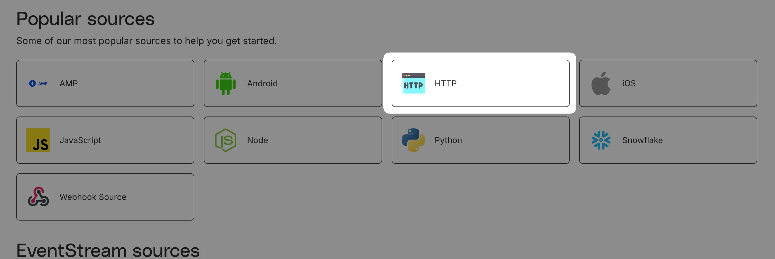

Setup a new “HTTP” source, name it and then note the “write key” it gives you.

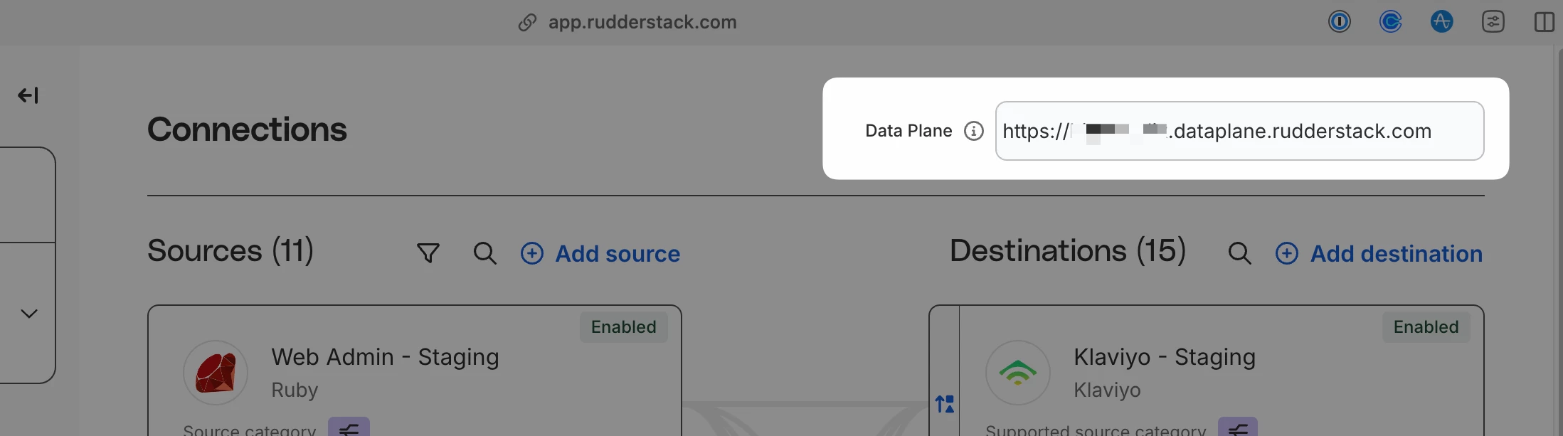

Next, take note of your “data plan URL” that’s at the top of your “Sources” screen in rudderstack:

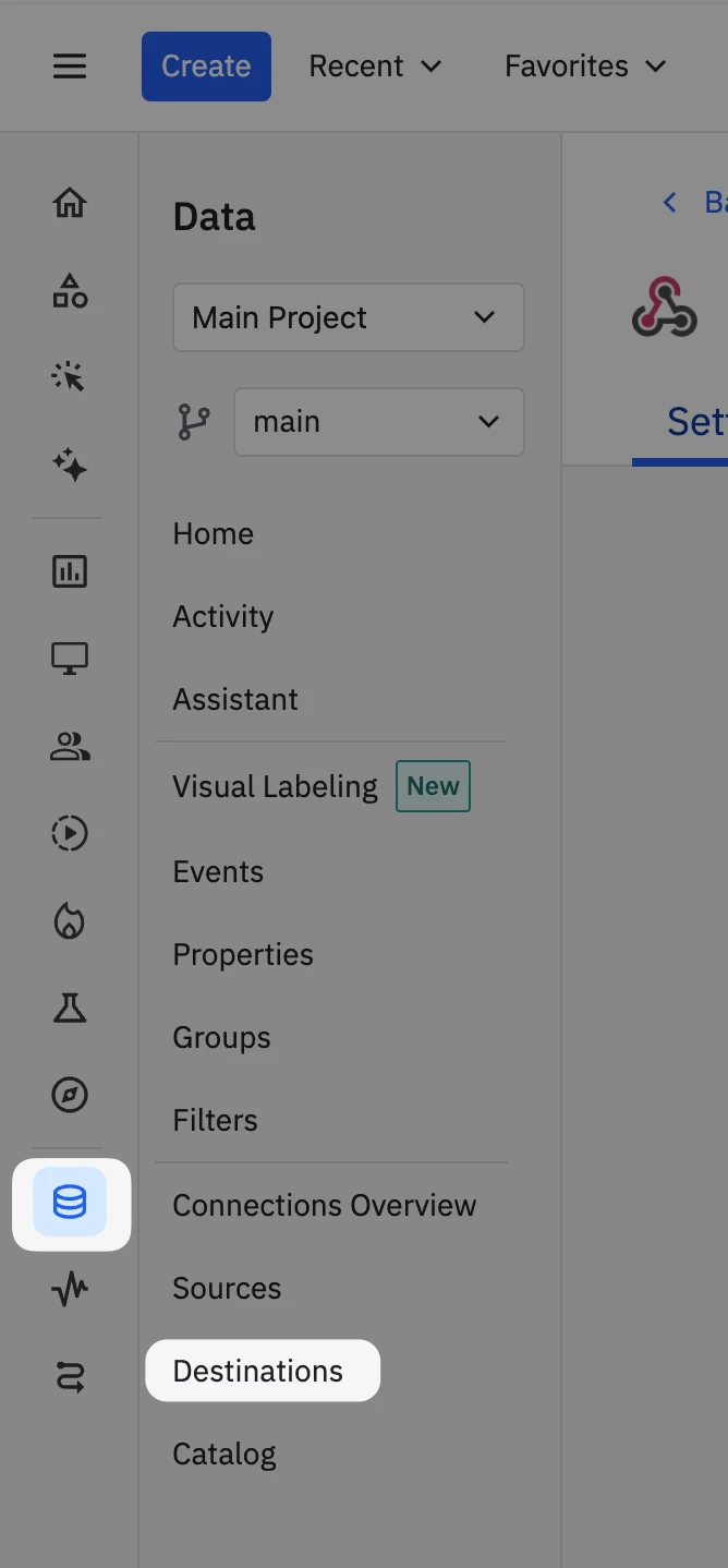

Create a new destination in Amplitude by tapping on these menus:

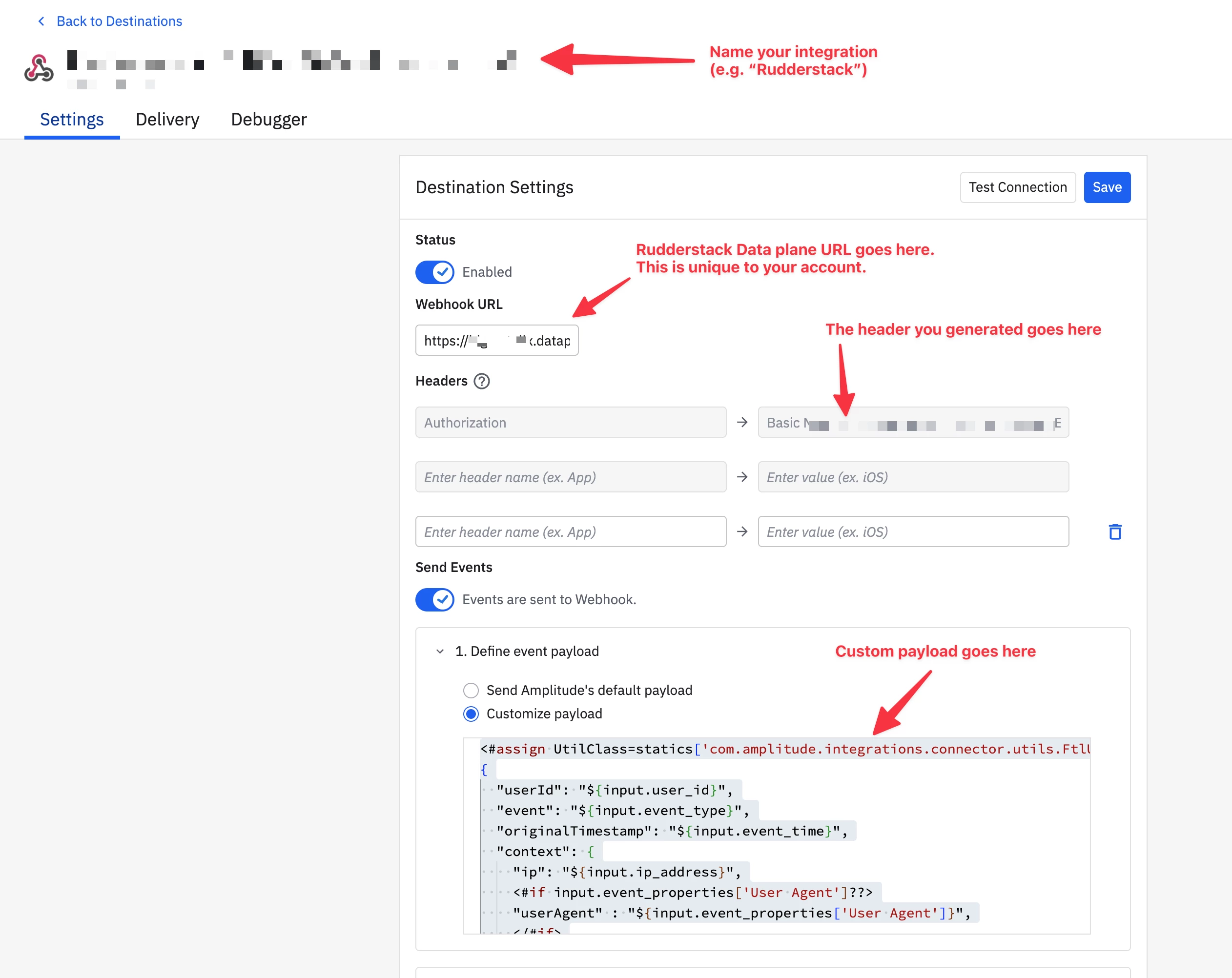

Now does this setup:
In the “Custom Payload’ section I indicated above, this is what tripped us up for so long due to the syntax that Amplitude uses.  After a bunch of iterations over the past few months and discussions with Amplitude support this is what we ended up with which gets it in the right format for how Rudderstack expects, and passes on event properties intact.
