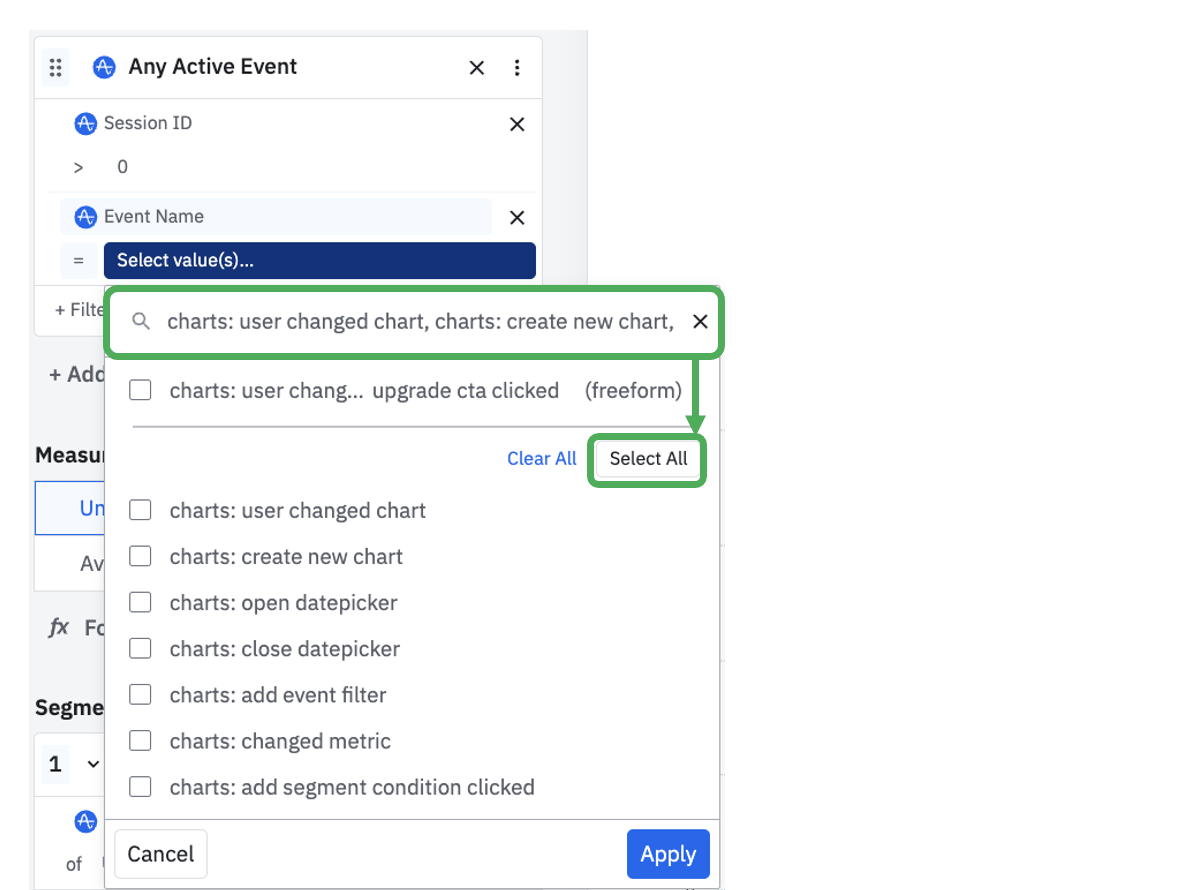

Q: Does Amplitude support passing in a list of values into a property filter?
A: YES! 🚀
Just separate the values with commas and be sure to “Select All” after you copy & 🍝 into Amplitude.
Side note: make sure to trim any whitespaces before and after the values before pasting into Amplitude to ensure they’re valid property values.
